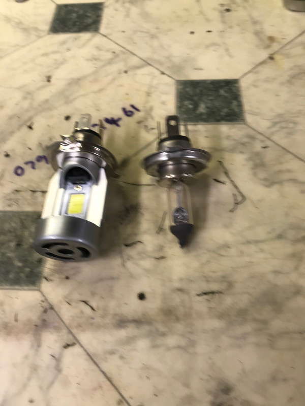

So when I bought one for the thirteen, I looked for a safego one again. They have evolved. instead of the fan being on the back of the bulb, its bike specific, so its on the front, so youve got no intrusion into the space for the wiring in the headlamp shell. And they are cheaper too, now £20 a bulb instead of thirty. Best of all, they are even better than the older ones (which are still going strong after three years and 16000 miles).heres the bulb, and before and after pics in the workshop, though yu cant really tell how much better they are without useing them out on the road. Far less current draw on the bike, and a lovely pure white light instead of an amber glow lolImage

LED or HID in a Halogen light unit is an MOT failure. They also blind every poor sod coming towards you.
Get osram night breakers you will be able to see further due to the fact it will give a correct beam pattern you won't blind people coming the other way and it won't invalidate your insurance because you have made your bike not road legal (yes they will if they can get out of a claim)
It's also safer because a blinding white light is difficult to judge how far away it is.

Post by Lampy » Thu Feb 27, 2020 8:04 am
Not a spoilsport just one of the poor bastards who gets a retina taken out by someone coming the other way running these.
Halogen lamps are design to work with Halogen bulbs thats why the lens is designed the way it is.
Anything else and there is so much light 'scatter' the projected beam image goes nowhere.
Lighthouses can be seen from miles away and they run on what is basicly a 40w bulb.
It's not how much light it's how far it's projected that counts.
